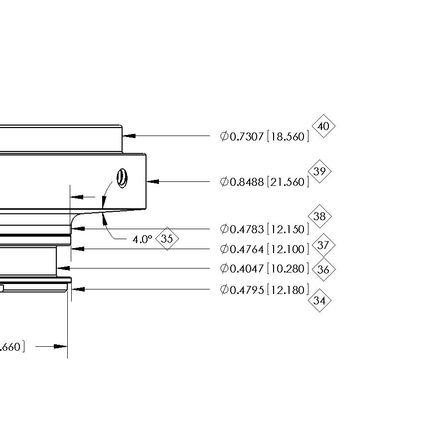

Hello everybody, I am a young Torontobasedmechanical designer working for a casting company. I am tryingtofind information on how to number critical dimensions inanautomated fashion. Ideally I would like an option that I canchooseseveral dimensions on a drawing, and they would automaticallybenumbered 1 to 30...etc., and when one is deleted, the number isnotreused. I would be using this for our foundry to be able toeasilyconvey the message of what critical dimension they aretalkingabout over the phone, and to use a list of the dimension #'sforinspection documentation. We are currently numbering themwith'notes' individually. Aside from the labour, another problemwithour current form is that the notes aren't attached tothedimensions, as that is far too much work for us SW guys, andthatwhen a dimension is moved, you have to manually move the notealongwith it. We are currently using 2007, but will probably beupdatingto 2008.

I use Numbered' Dim's too. Man that would be great if itwasautomated.. Lotta my drawings have 100+ dim numbers, so thetimesavings would be significant. For me, I make a Note set toDiamondoutline, with a digit inside.. Saved that as a favorite.When i goto number the dims, i place the first one, and luckily thenotefeature works in line. Place one, type the number, place nextone,type number, repeat... Ayhow, I'd love to see thisautomated..

Here is how i need Dim Numbers.. (The numbers in diamonds)Each dimgets it's own number.

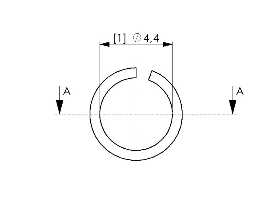

Hi
Is there no way to make the numbers appear in the dimension textinstead of just an annotation in the proximity of the dimension ?This way the numbers would follow the dimensions when you're movingthem around at a revision.
Design Engineer
TEMA
Sweden
MA
MA 2007-12-13
Yes, you should be able to do that using the DisplayDimension.SetText method. However, you can't insert any symbols that don't have a text equivalent. For example, a triangle note with a 1 inside would be .

Thanks for your reply.
I've been trying to apply it to your macro above but with nosuccess...
Unfortunately I'm not that good at programming macro's... Whatwould the code look like to make the numbers appear like the imageattached above ?

Here's an example of DisplayDimension.SetText. I encourageyou to read the API help.
Dimension.SetText swDimensionTextPrefix, "[" & Format(NumValue)& "]"

Hi and tx all who have been replying to my question.
The code you gave me solved almost everything. The numbers come upat the right place, but unfortunately it removes the text that wasin front of the dimension, a.e. R0.7max -> [1] 0.7max.
This is although a minor trouble since we don't have many of thosein our drawings.
Thanks once again.

MA 2007-12-17
You could try getting the dimension prefix first and thenadding the number in front of that, instead of replacing the entireprefix.
strOldPrefix = Dimension.GetText ... (I don't know the syntax forGetText offhand. Check the API help.)
Dimension.SetText swDimensionTextPrefix, "[" & Format(NumValue)& "]" & strOldPrefix
