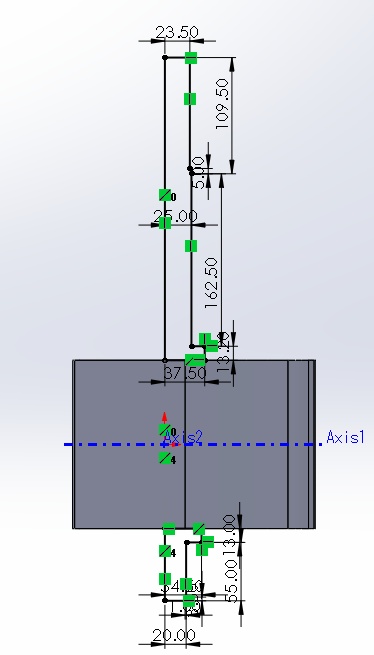

Recently I observed there is sudden change in Dimensions format in model, It looks bigger with Open arrows, (  I would like to use SW STD style, closed arrow with pleasant appearance)
I tired to reset the settings in Tool>>settings but dimension is showing same format, I cleared registery, but in that particular file still ODD dimension occur.

Hi Sanjeev
Did you look in your Document Properties?
These are the options that get saved with a document as opposed to System options.
You can edit them for the current document.  If required you can create document templates.

Thanks Edwards, Problem was here only, most of the parameters was scaled by 2.
