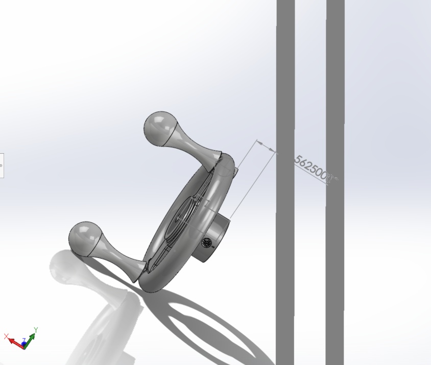

I've been using SW for a few months, so sort of a new-be.  Just today when I created a dimension in an assembly (not a multi-part body) to check a distance the system created 2 large bars at the head and tail of the numerical values.  Any idea why?  And more important, what can I do to eliminate them?  I have tried various settings in the Property Manger, but all to no avail.  I don't believe I have made any other system changes.

This looks like a rendering issue. Does it occur in other assemblies or files, or just this one?
Have you checked that the drivers for your graphics card are the latest certified drivers? You can check them here SOLIDWORKS Hardware Certification | Hardware & System Requirements | SOLIDWORKS

Hello,
Does this anomaly survive:
  1. Save, close and reopen?
  2. Someone else opening it?
  3. SolidWorks restart?
  4. Windows restart?

This morning I checked the original assembly and another one and both are showing correctly.  Not sure what happened.  Perhaps it does have to do with the driver, but I'm running SWX 2016, so support is a bit limited.  The shut down and restart of Windows over yesterday may have solved the issue as well.  At any rate it's working as it should now.  Thanks for the the ideas!
