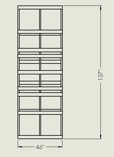

Hello all,
My question is regarding formatting dimensions properly, and also how can these changes be retained for new drawings in the future.
When dimensions are shown between the extension lines, I want them to split or break the dimension line ( as shown in ‘example’ image)
I understand that I need to go to Options>DocumentProp>Dimensions>(LinearDimension?) and change the ‘text position’. Only problem is when I do that, the dimensions that are represent vertical dims will no longer orient towards the horizontal  (see attached image). So when I change to the other setting, my horizontal dims are no longer creating a gap for themselves in the dimension line… Any help regarding this would be greatly appreciated.

<p>Sean Weitzel wrote:</p><p></p><p>  I understand that I need to go to Options>DocumentProp>Dimensions>(LinearDimension?) and change the ‘text position’. Only problem is when I do that, the dimensions that are represent vertical dims will no longer orient towards the horizontal (see attached image). So when I change to the other setting, my horizontal dims are no longer creating a gap for themselves in the dimension line… Any help regarding this would be greatly appreciated.</p>
First thing:  See if switching your overall drafting standard works for you.  Then Save your Sheet Format and your template.
Edit: adding picture for clarity:
Read # 2 here: and read # 26 here:
<p>Sean Weitzel wrote:</p><p></p><p></p><p style="padding:0px;min-height:8pt">Also, what must I change so that a new drawing does not, by default, show the origin point of each individual component? A minor annoyance but still would like to get that removed by default.</p><p style="padding:0px;min-height:8pt"></p><p></p>
This would be in your template.   Hide it in a new drawing and then update your template.  (see the links above)

Thanks Dan,
for the record I was able to access the previous drafting standard and save that file to a location wherein I could load onto our new stations
