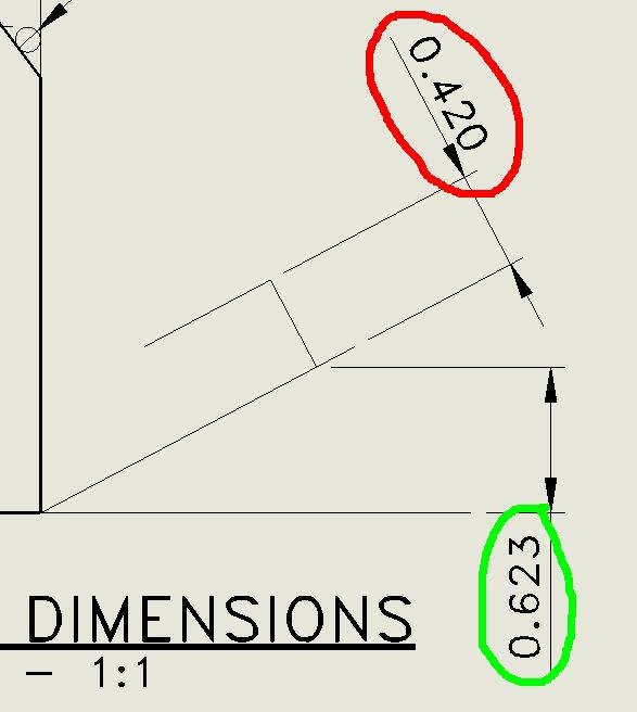

Is there a way to flip the dimension to the other side of theline?Example: In the image attached I need the dimensioncircledin red to move to the other side of the dimension line androtateto look the same as the one circled in green.SolidworksDrawings And Detailing

Try switching your dimensioning standard (ie ANSI toISO). Sometimes that will get you the look you want.

Hi,
I have the same problem encountered also and I want to know is thera short cut method or icon as a "match properties command" so thatit automatically align my text horizonatally if i need it. Usuallyit take at least 6 click to change vertical dim to horizontal fontsdisplay.

Have you tried to create a dimension favorite?

Usually dimensions are placed all-horizontal, or betweenhorizontal and 90° viewable from the RH side.
I don't believe there is any standard which allows dimensions to beoriented upside down or past 90°.

Sometimes, due to space limitation, I need to change my verticaldimension to horizontal fonts and it takes me 6click to made itthru changing its properties. I tried to use favorite but onlytolerance can do.
Hi Jeff, Can you enlighten me on how to do this in 1 click atfavorites setting?
