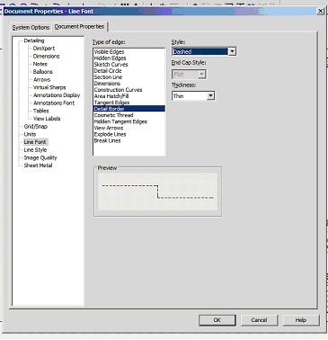

I can't remember whether this is an option in '06, but it isan option in '07. You would have to look in Tools/Options/DocumentProperties and select Line Font.
I will try to attach a screenshot of it. You just go to Line Fontand scroll through the drop down menu to Detail Border to selectthe desired option.
Hopefully, this wasn't too recent an addition for you to do justthat... I would hate to have to use a 2D sketch in a drawing likethat, but the detail border that you have in mind will certainly behelpful in your example view...
Ryan

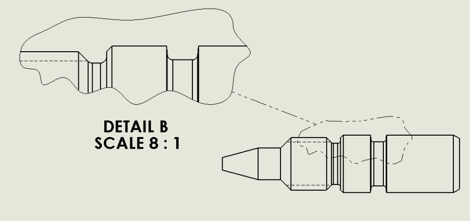

Art,
You can use a spline or other shapes to display as the Detail"profile" and view border but to do so, you must change the DetailCircle Style to; With Leader, No Leader or Connected.
See attachment.
SF
SF 2007-08-10
Art, the trick to get the shape is to draw the border first(e.g.with a spline), select it, and then click the Detailtool.
