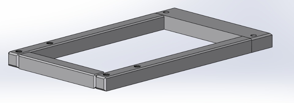

Weldment assy (4 parts):
Want to make a single part (not assy, as the weldment is now a new single part) from the above that would be the finish machined with a new part number

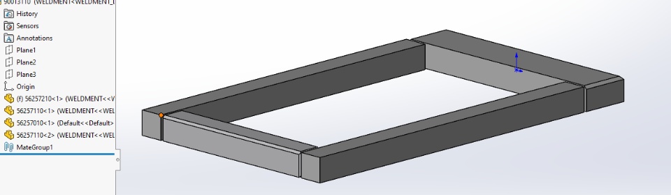

As  said, in Solidworks the workflow is to model the "assembly" as a multi-body Part.  I do that for almost every project, and it works well for me.  A cut list, which is similar to a bill of materials, is automatically created in the multi-body Part, with properties like "LENGTH", and the cut angles, added in automatically, along with whatever properties were saved in the profile sketches used to create the weldment features.  (See the screenshot below.  Similar properties are there for the other two bodies.)  You can also link Drawing Notes to these properties.
