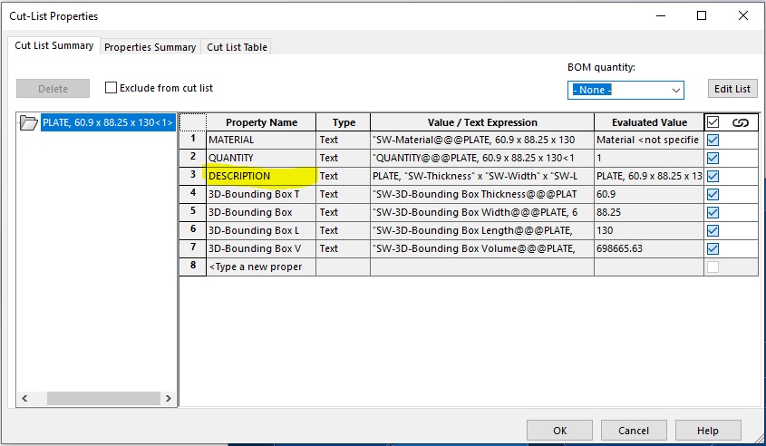

Hello,
Does anyone knows if it's possible to rename property name in cut list summary? For example instead of ''DESCRIPTION'' I would like to have ''Profile''. I'm asking this, because I'm already using property name ''Description'' for something else in other parts.
Thanks in advance for any kind of help.

Hi Brice
You could add a weldment to an empty part and add the properties to it.  then save as a template?
If you have old files to alter, you can make a property tab using property tab builder.  Or maybe a macro

Hi,
In other parts my description is ''sheet'' (like sheet metal part), here I wanted to keep description as ''profile''.
But if it can't be done, then the solution I just thought, would be adding the stuff I want under different name than Description.
RE
RE 2021-03-26
Hi Brice
AFAIK You can create any weldment properties you like
Just use the same syntax that SW generated for you in the description.  You can combine other properties or even bring in model dimensions.
Here I added the Profile property directly to the weldment feature before I created my cutlist and voila!
So I've not renamed the description property - I've created a new one.  Is there any difference?  I don't think so, either delete the description property - or leave it blank.
Give it a go and see what happens

Hi Brice,
DESCRIPTION is a special beast: a lot of automation is going on behind the curtains. Personnally I wouldn't interfere with that.
I would rather go the other way around. What are you DESCRIPTION using for in other parts? You might consider change it there.
Eddy

Hi Brice,
For weldment profiles you can get the name in the cutlist tree automatically .It uses the Description value for that.
Just add this to the weldment file as a custom property "Description".
You can use a weldment profile file (.SLDLFP) for your plates also.
Remark: if you change your .SLDLFP file afterwards, this information is not updated in your design. For that to happen simply choose another one and choose the wanted one again. Then it will update with the changes you made.

BB 2021-03-26
Yeah that might work, I just tried it. But I wanted to keep the DESCRIPTION part for my own purpose.
With that I will basically create the same thing under different name. The goal of this was to rename the DESCRIPTION, and then create my own description with my own value/text. I think I will keep it like it is, and just use something else instead of a word description .
