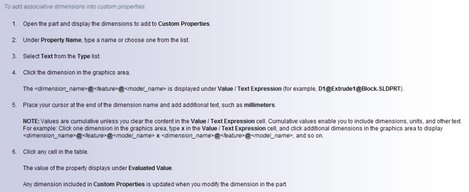

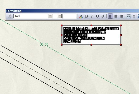

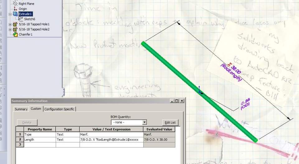

In the examples below, I created a Custom Property named Length andadded it to the list. The Length of these shafts increase ordecrease as the assembly requires. The O.D. is constant. If theO.D. changed as well, this value could be added in place of thestatic O.D.
I flagged it off and used Length in my Detail Note. I imagine youcould do the same in a column on the BOM.
I am assuming the size you wish to use exist as dimensions withinyour component already.
