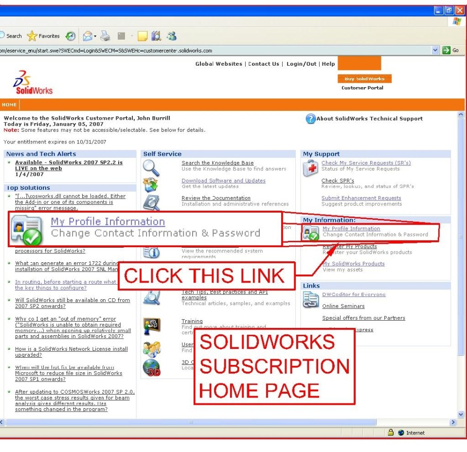

I think the user name is set in your subscription accesspage. (see attached)
Good luck.
