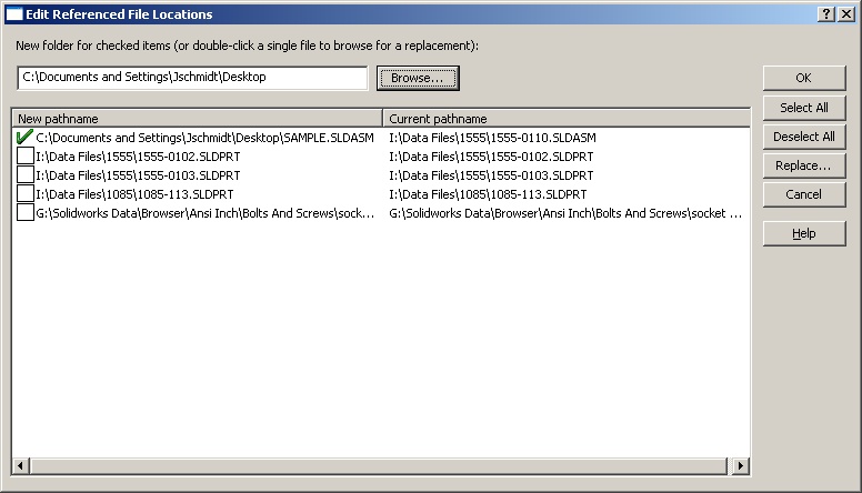

To copy an assembly and it's associated drawing:
Open drawing
File > Save As
Browse to desired location
Change the file name (required if saving to the same directory assource file)
Check "save as copy"
Click on "references"
Check the box next to the assembly and/or parts you want to copy.(see pic)
Click "okay"
Click "save"
You can copy a part and its drawing the same way.
