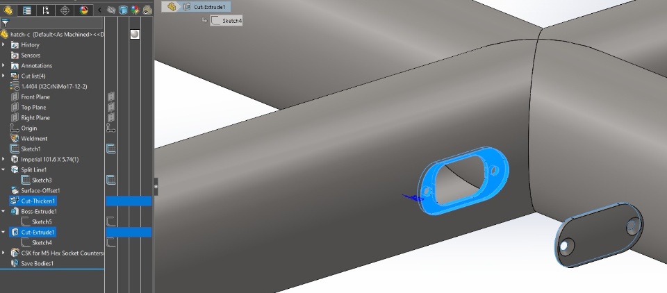

Hello Everyone,
I have a similar question but different model that might need other techniques.
I have seen several videos and Matt Neuman's comment that referancing to planes nor points will not work.
However, in my situation I do not have any planar surface other then referance Front Plane, thus, I guess thats why I cannot save it as a library feature.
Any ideas would be greatly appreciated, otherwise I will have some fun with creating approximately 50-100  cut feature like this manually..
I attach the SW2020 file for you to see..
SolidworksParts And Features
Comments 2
BD
BD 2021-03-26
Hey Wayne,
Thank you very much with your guidance through the existing model in solidworks library.
I tried to do that as in below screenshot, however when I try to save the file as library part, it gives me the following error.
Am I doing something wrong here ?
I attached the file again.
WM
WM 2021-03-26
Look at how the SOLIDWORKS supplied Design Library rectangular keyseat library feature was created in the ifeatures\nch\keyways folder. They start with a sketch on the flat end of the shaft, insert that is used to create a plane tangent to the shaft diameter. That sketch and plane are then included in the library feature. It will add extra features to you model
