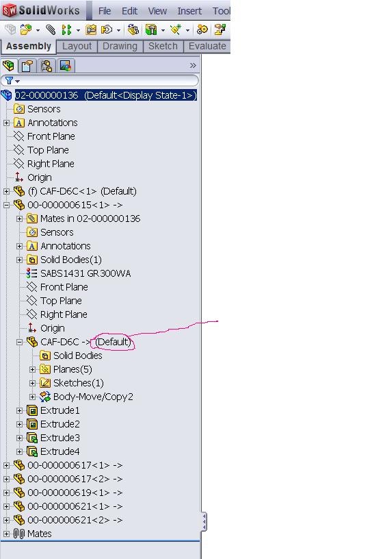

I have the following:
1. Assy with 3 parts
2. The seed part (derived Part) as the first part in the assy.
3. 2 parts containing the derived(seed) part
Now if i make any geometry changes to the seed part everything elsefollows. The seed part has design table driven configurations. nowwhen i change the seed config i expect the derived parts also tochange but they dont and there is no way to take controlmanually!SolidworksConfigurations design Tables
1
DL 2009-06-15
Yes, very frustrating. I think that SW should improveconfiguration referencing for a lot of reasons, yours included.Updates across all configurations of referenced parts andassemblies should be automatic if the files are open, even if theconfigurations are not active.
