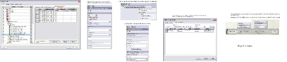

I just want to clarify something... Did you use the Toolbox"Configure Data" interface to enter all your data?
If you use that interface, and drill down to each fastener's "AllConfigurations" table, you can enter a Part Number, Description andComment for each configuration. The Description is the only itemthat gets written as a configuration specific custom property. ThePart Number and Comment are written to the Properties of theConfiguration (RMB on the configuration in the ConfigurationManagerand select Properties...).
The Part Number is written as a "User Specified Name" in the "Partnumber displayed when used in a bill of materials:" field.
The Comment is written to the "Comment:" field
I've attached an image that I hope helps.
This should work perfectly, provided your Bill of Materialstemplate columns are set up to extract this data. If the BOMtemplate was customized to extract differently named customproperties e.g. PartNo and Desc, then those fields in the BOM willbe empty.

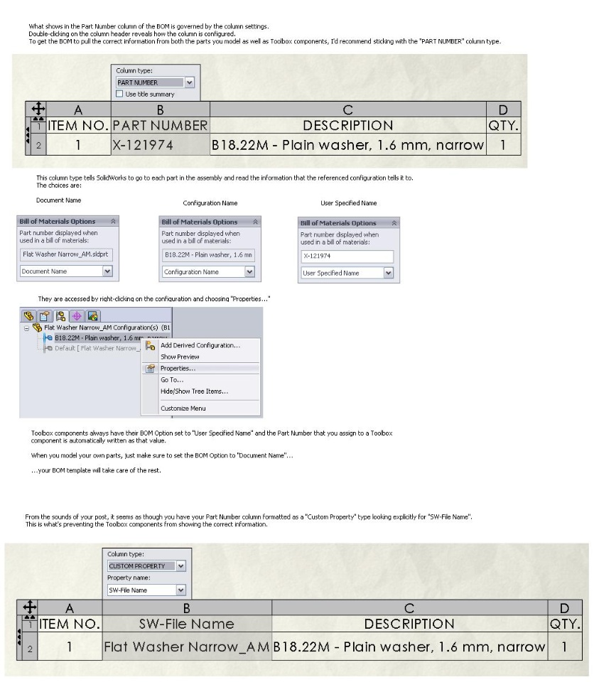

When you say that SolidWorks doesn't support any variation of themdb files, what do you mean? As I understand it, you are looking toget the Toolbox items to show up correctly in your BOM - morespecifically the part number.
It sounds like you've formated the part number column in your BOMto pull SW-File Name - instead of using the generic "Part Number"column. If that is the case, can you explain why you decide toformat the BOM this way? Are you aware that the generic "PartNumber" column in the BOM will pull the file's name provided thepart's configuration has the "Part number displayed when used in abill of materials:" option set to "File Name"?

I figured it would be much easier to use the SW file for my partnumber field in the BOM because my file name and part numbers willbe the same and I also type in the description when saving the fileand this to is displayed on the title block. I think it is a verysimplified. It works beautifully but not with the features oftoolbox.

I've attached an image that contains some details about how Toolboxfunctions with Bill of Materials. I hope you find it useful.
