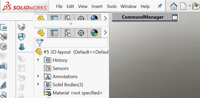

My Command Module Moved and now floats and I cant get it back on top. I run 2019 and Ive ​​​​​​​tried everything I could find on internet to no avail.

While dragging the CM, look for the Dock at middle of window.
Don't ask why they design it like this and not just drag it to the top like everything else.

I drag it,. but I dont get that arrow.

OK, I had to unlocked it first. It's back, and thankyou.
