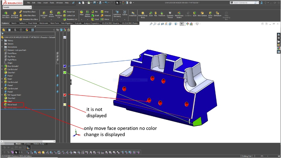

I am having a problem wanting to apply color to the move face operation.
when I apply in other operations solidwork respects the color only in the move face operation it is in which I battle

I believe this is a limitation of the software. Coloring of a feature will only color the faces created by the feature. Your move face feature only moves the faces, it does not create the faces. So the color of the face will be dictated by the feature that originally created the face. If the move face feature created a new face, then that face would get colored, but the faces that weren't created by the feature would not. Another example where this happens is the draft feature.
You can tell what faces are created by a feature, and therefore what faces will have their color controlled by that feature, by selecting the feature in the tree and looking at the shaded faces in the graphics area. If you select the original hole feature, notice that the faces of the hole are shaded in the selection color. If you select the move face feature, only the edges of the feature are highlighted, not the faces, indicating that the faces are not created by the feature, but just manipulated by the feature. Again, if you add a draft feature and select it, you will see only the edges highlight, not the face, and therefore, the appearance applied to a draft does not change the face colors (unless it is a type of draft that adds faces).
A workaround is to apply the color to the individual faces, not the feature.
I would suggest submitting an enhancement request if you would like the software to optionally apply colors to faces that are modified by a feature in addition to those created by a feature. I believe this link should take you to the enhancement request interface but you will be required to login to the customer portal: https://onesearch.3ds.com/solidworks/page/sldwks_er4cp?q=

HI ,
Try changing the appearance option from the feature to Face and click the moved face.Initially it applies to the features as default in geometry selection.
