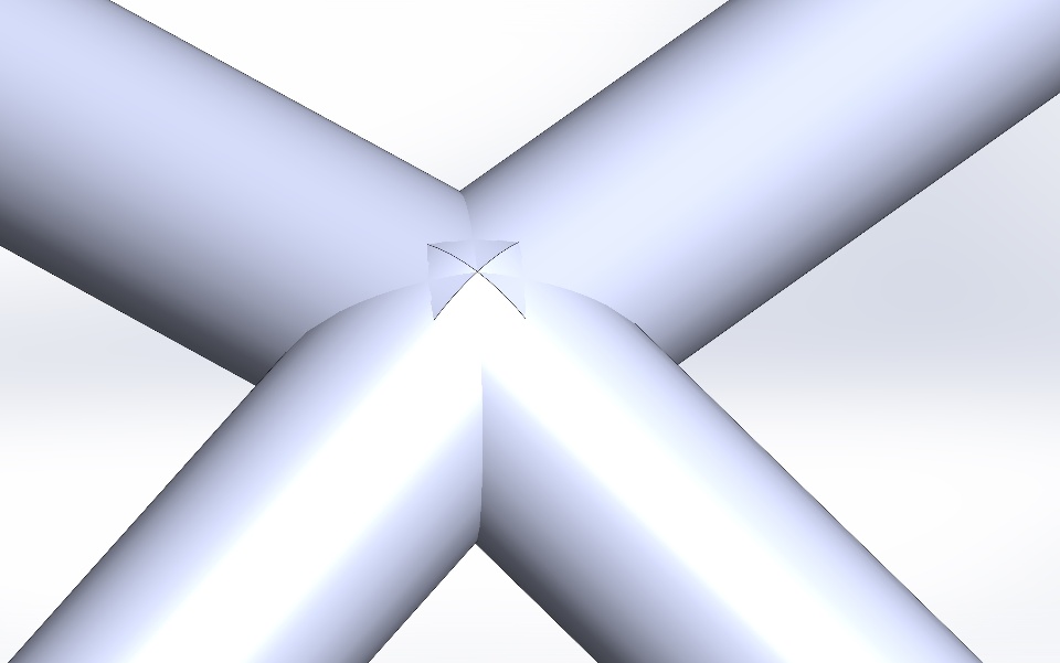

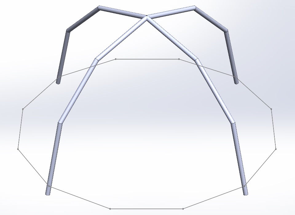

Having a bit of trouble with a model I have been working on. I have a circle profile swept along a sketch consisting of segmented line. The initial sweep properly miters the round provide per the angle of each segment. However when I do a linear pattern of the sweep at 90 degrees, all the way at the type where the two sweeps intersect there are "left over cut offs" for the lack of a better term. If I was cutting a physical round pipe they would be just loose cut offs. What is the easiest way to get rid of these?
I tried drawing triangle profile and doing extrude cut up to the pipe surface, but it is very tedious. Is there a simple way?

Also, if you first Combine the bodies into one body, you can then use the awesome Delete Face to get rid of those bits of geometry.
Edit: actually, do both at once using Intersection.

I tried delete face, but it doesn't accomplish a sharp miter on the top, it almost "grinds off" the left overs and leaves a smooth top instead of giving me sharp cuts. I will try to experiment with weldments, haven't tried that yet at all.

Weldments did not work properly either, it would only let me chose 2 lines at a joint in a group, and next two lines in a new group. It miters the two profiles from the first group, and then butts the items from the next group instead of giving me a uniform joint across all four profiles.

Or you can make one instance, extrude surface (blue), use it for Cut With Surface command and pattern result. As bellow. Is much way for make it.

Yep, I though about doing the extrude cut but was hoping there is something more automated.
Weldments do not work for me because of how that joint is setup, i'd like the same miters on all the members.
That being said, in your weldment, how did you get your display to show all the contours so nicely? Look at the photo I posted, I have lines that are popping in a weird way.

I didn't do it. Maybe the certified card and drivers? And more stable SW?
