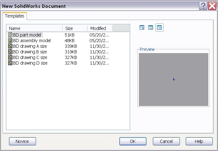

If I select "New" in the "File" drop menu, I get a windowwith a list of templates (see attachment.) If I have a part orassembly open and make a drawing from it, I get a similar window.Of course I made all the template files, put them in our templatefolder, and set options to look for templates in thatfolder.

Not quite what I was looking. I want to open a template andhave the sheet format menu come up right away with out going to theproperies section. Attached is a screen shot that I would see if Ijust opened a new drawing template.
