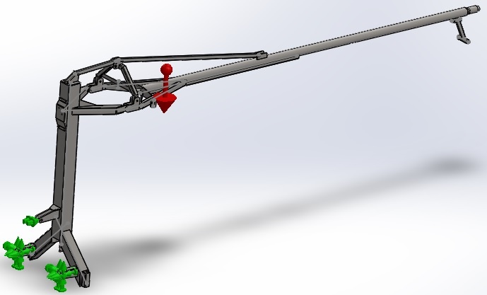

I`ve drawn a steel structure in SW and want to do a static analysis. Here is what happens:
When I open the static study I get his message:
"Problems have been found while creating joints due to short beams and wrong neutral axes of them. Check the highlighted beams and their neighboring beams".
I just click OK. (Is this something that will make any troubble?)
When I have made the fixtures and appplied the force/gravity I run mesh. Then I get the message:
"One or more joints lie inside solid, and cannot be bonded. Model may not be stable"
I press OK. And then it try to start meshing, then this message appere:
"At least two bodies are interfering. Do you want to check interference?"

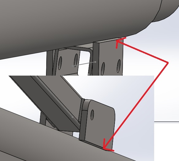

I find some parts that interfere, about 0,000123mm. But it`s very complex to do the changes. So I choose Global Contact – Incompatible Mesh. Then run mesh, the meshing works!
New message: "Beam is not properly bonded to shell/solid". How do I bond?
I change all the parts to solid, then run mesh. Then run analysis
Model is unstable. Check that you have applied adequate fixtures to stabilize the model.
Here I use the "Contact Visualization Plot" and see several parts that don`t have contact. So I think I need to set some connections. I use the "Rigid Connection" and chose the faces of the parts. Then I run, and it works. But is the "Rigid Connection" the best connection for these parts. They will be welded when I manufacture the product, what connection will make the most precise study you think?
Can I do this analysis with beams? If so, how do I fix the neutral axes and how do I bond them to shell/solid?
I have attached a file of the model. Hopefully someone can help me, this is a little-bit frustrating

I took a quick stab at this one.
Downloaded at 7:51 am, running at 9:59 am.
Full solid, full contact. Fixtures are modeled pins in contact. Run time about twelve minutes with mesh of about 400,000 8-node tet elements.
Force data is available at every joint, including the wooden bushings.
Note that the welds are based on very rough guesswork. The welds are not gapped. Modest liberties were taken to ease joining and meshing. Not really knowing the application a simple load case was made up. The whole thing is still a bit coarse, especially at the bushing contacts.

SM 2021-04-08
I can see only limited information coming from a Solidworks 'beam' model of this assembly. There are many brackets, pinned joints, and weld beads - all areas of key interest in a structural simulation. The few long uniform tube sections are simple to analyze separately, or one could use this model to make a very simple starter model to look only at bulk response of the system.
Were I to study this assembly, it would look something like the simple example at
Connector or Crutch? – Stone Lake Analytics, LLC
Here each weldment is treated as a single solid and the weldments are joined with pin connectors, or literal solid pins with contact conditions.

all those supposedly welded points must be bonded correctly. Shrink fit or modify the part. I wouldn't use shell in this model

You may also find the following helpful:
  1. Build the study gradually - initially, exclude all bodies except the bodies which have your primary grounding fixtures and their immediate neighbors. Apply only a gravity load to verify expected bonding.
  2. The Treat as Solid option - see 2020 SOLIDWORKS Help - Beams and Trusses Overview
  3. SOLIDWORKS Knowledge Base (KB) solution S-049030: "When not to use Beam elements"
  4. The Non-touching faces option for Global Bonded Component Contact - see 2020 SOLIDWORKS Help - Component Contact PropertyManager
And if your forum post does not yield enough assistance from the community to help you move forward with your analysis, please be sure to contact your SOLIDWORKS Value Added Reseller (VAR) for assistance.
