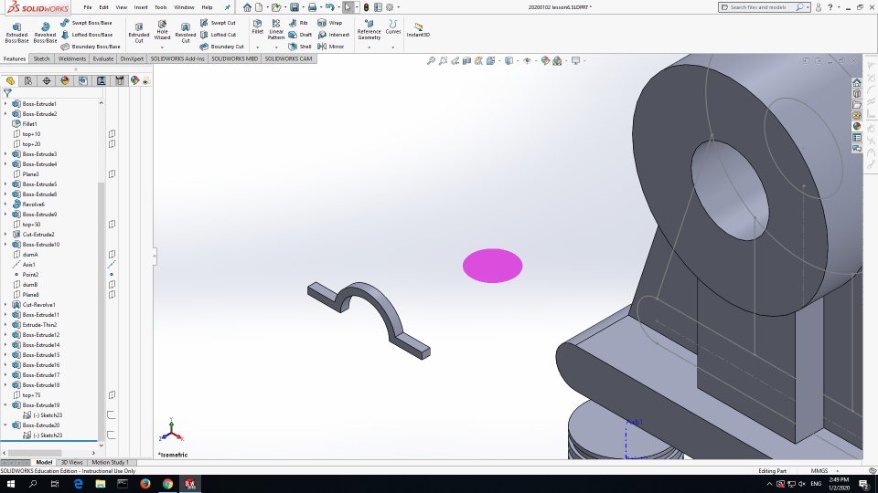

Hello guys, I am a newbie on using Solidworks. I would like to ask that how to cancel/delete the circle in purple colour in the photo shown above. I accidentally created this circle by using the "contour select tool" command. Now, even I cancelled all the related sketched, this circle still exists and I don't find any attributes(i.e. sketches, planes) does it belong to. Does anyone know how to delete this purple circle?

Based on the symptom plus the fact that you're using the Educational license, I would wager a rather large sum that you are not using a supported graphics card.  You can try different graphics drivers, or you can turn on Software OpenGL.

This could be a graphics glitch. Save your file, close SW and restart and check. If this doesn't fix the issue then share your file to check.

Yes, you are right. It should be some glitches since I just opened the file today and it disappeared.
