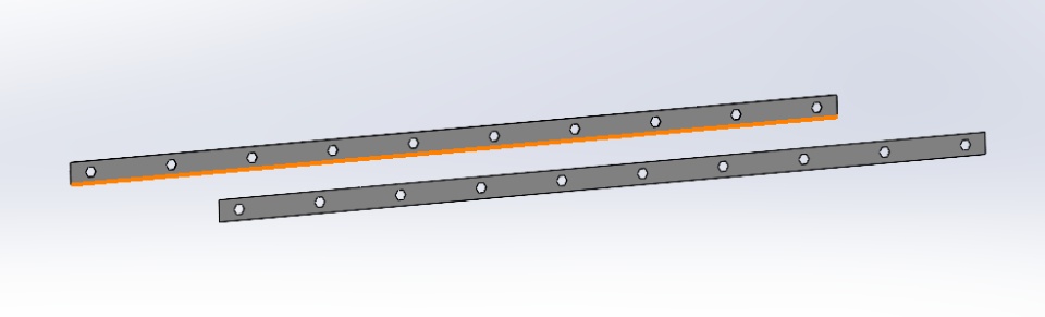

Can you apply a linear pattern to extrude cut along a lofted, contoured surface?
Hello all,
I am new to the forums and apologize in advance if I am not following proto when it comes to posting. I am here seeking help/advice to learn how to apply a linear pattern to a lofted, contoured surface.
My goal is to evenly space out polygons so that I can extrude cut through all. I will attach an image of the spacing and extrude cut as well as the part I am wishing to perform this on to help visualize.
I have read in other posts that sometimes it is helpful to upload the part file itself so I will upload it here as well. I want to also note that I am a novice user of this software but understand some of the basics. So, please have mercy on me.
I appreciate any and all feedback.
Thank you.
Figure 1: This is the linear pattern and shape (hexagon) that I wish to achieve.

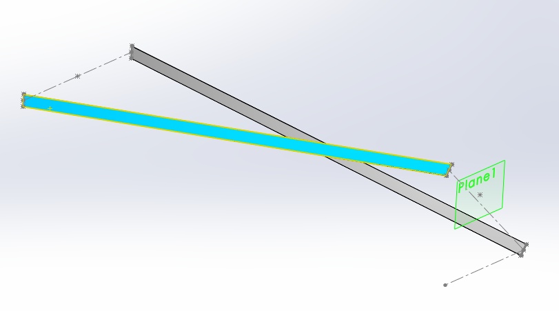

Figure 2: This is the part I wish to do it on. It is lofted from one sketch to another. The loft is contoured, not flat.

Thank you for the advice. I was able to generate the pattern on the other loft face and get the holes to align. I will try again with some of the alternative methods you mentioned above.

..I did not check the alignment (you could make a new curve/face).. but you should be able to by including the other loft body in the cut... or you can do it another way,.. Extrude (Merge Off) a rod.. and Curve Pattern the rod (so you can insure it is where you need)... and Combine Subtract?
btw,.. also consider a Helix (Sweep, much more accurate)) instead of the Loft.

...a Curve Pattern?

There are number of ways to do this but this is an easy way.

I think I am following what you are saying, however, the pattern must follow along the loft. Which is where my knowledge of SOLIDWORKS ends. I would like to know how I can get the linear pattern to follow the contour at its centerline. The bottom image is to give reference to how the shape contours from start to end.

Dan, could you able to sketch the pentagon at the left edge of the rectangle sketched. if you do then simply follow the "linear sketch pattern" from the sketch toolbar and change how many numbers of objects you want and select which entities of the pentagon and you will get what you want. I hope it works.
