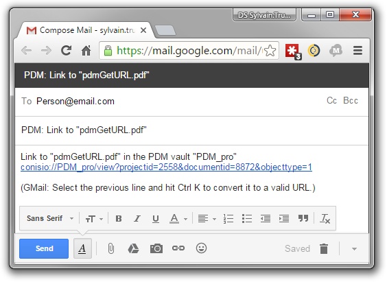

pdmGetURL.exe is a tool to get the URL of a file in a PDM Professional vault.  This application requires SOLIDWORKS Enterprise PDM 2014 or higher.

/Output:{mailto|gmail          |none}
Specify how to send the URL.

/Output:
mailto
Use default email application to send the URL.
gmail
Open a browser to https://mail.google.com to send the URL.
none
Do nothing.  Useful when using /Clipboard:yes
