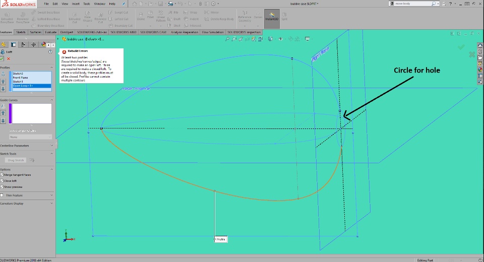

For some reason, I'm always having this issue with lofted/boss feature.  I'm sure it's due to my lack of understanding of how it works.  I'm just trying to create a lofted bubble object per the image below.  It keeps giving me this "at least two profiles are required to make an open loft).  I'm not sure whether I understand what it means since I thought I have all of the lines already interconnected.  Please advise?  Major headscratcher for me among many other things.

I know you've already figures it out, but just so you understand why it wasn't working initially, look at the PropertyManager in your original screenshot. You have all selections in the profile selection list and none in the guide curves. You also have a plane selected in the profile selection list which is not an appropriate profile.

..I knew you'd figure it out!... in this case, you need to choose the "group" option.

Thanks for showing me how it works with the open group.  Not sure why it didn't give me the option on how to select the open group.  I caught it by accident.  What I did was, I click Lofted surface and on the "Profiles" box, right click and click on "Selection Manager".  Then, left click on the line>right click on the line and it selected that line as "open group".  Keep clicking on the rest of the lines and I remember to click on "close lofts" on the options on the bottom left.  That just does it.  Also, you use "Lofted Surface" instead of "Lofted Boss/base".

Hmmm..   Thanks, everyone.  What did I miss?  I tried it all and it keeps on giving me the error on the image I originally attached.  The only thing that's different is I saw you guys added a circle or two in the middle with pierced point.  Is that what I missed?  Thanks again, everyone.

I think the feature manager is what enables me to select each of the splines as a group.  I tried it without the feature manager and the error you see in my original posting graphic.  As to why I choose to use the Loft?  No reason actually.  Cuz that's the one that works for me for this experiment and it actually generated pretty round but not perfectly round.  If I needed it to be perfectly round, I'll do what Maha suggested.  Your "Revolve" approach works as well.  This is why I love SWX.  There are so many ways to achieve the same goal.  However, in my case, it won't work because the height for the top curve and the bottom curve are different.  Unless revolve can use 2 curves as the guide line.

Good catch with the plane (I didn't even see it) and thanks for the side note.   So you are saying that if I choose 3 of the splines and use the last spline as the guide curve that'll work?  I tried what I think you had suggested and I can't even select the sketches in the profile box now.  Strange how I got it in the original post graphic.

All the more reason to define your sketches.
Your profile sketches are not tangent to one another at the tip.

Follow the steps in Pauls image. Use RMB to get to the selection manager and group select your outer splines for the profiles and use the hole sketch as your guide. You can also try lofting from the hole sketch to a point. Or RMB on your loft feature after the fact and elect to add an additional loft section for further control.
Regardless, I would suggest fully defining your sketches at the very least.
