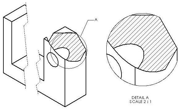

If the attached picture is what you are looking for, then onmy machine its working the same way as it works on other views. Itried on weldment and it was not working on them, so for a workaround, you can create a configuration with broken out feature andcan use that one in your drawing.
DG
DG2008-06-25
I also tried creating a break out view and a detailed viewand they work ok as expected.

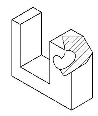

Deepak,
I do not think this is what Francis expected.
I my eyes, I believe the break out view is incorrect.
The breakout is parallel to the screen. To show or review this, goto the view with the break-out, then select the icon for "3DDrawing View", now rotate the view slowly to see the attitude ofthe plane at the cut depth.

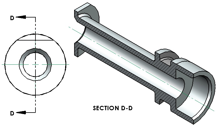

EDIT: To see what I would expect or like to see possible for a break-outsection, refer to the image. It is an Isometric Section but it isonly possible as a Full Section, so the capability is almostthere.

Is that sectional view a permanent view. If so how did you doit?
CC
CC2008-06-28
First create a regular section view. Then right click on itand select "isometric section view".
