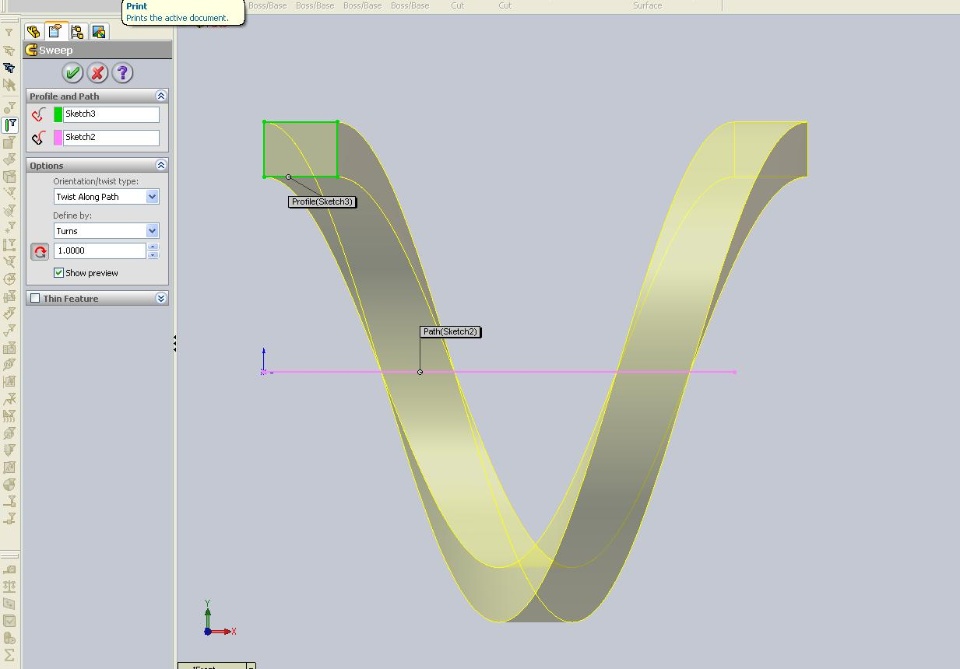

Did you try to make a sweep cut using the option of Twist AlongPath?
You just have to set the length of your path and the angle/turnsaccordingly (See attached picture).
