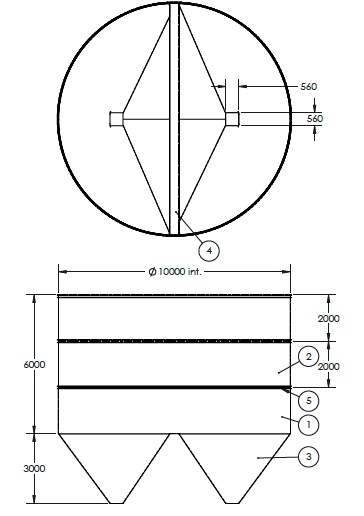

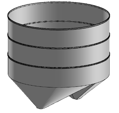

I got some troubles makin a biconical silo
As you can see I got some troubles at the end 560x560mm area...I know maybe it will be too simple but I can't see the result as it will be on real sheet metal biconical...Any Idea?

I have a dumb file at home I will uploaded at home.
Thanks I Will see it at office tomorrow, thanks pal
Hi Ruben,
I couldn't spend too much time on it, but I'd tackle it something like this (sheet metal added).
Hello Rubén
Can you upload your part?
Regards
Hi Ruben,
I'd try something along these lines. I did it in surfaces to to give an idea of the shapes but would be possible in sheet metal.
