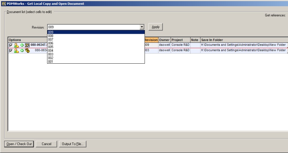

Hello Peter-
Previous Revisions are available in the PDMW Vault. See thescreenshot below.
