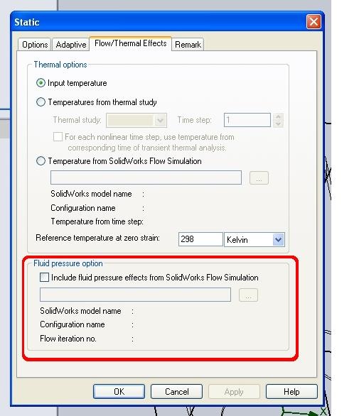

With COSMOSWorks, you can put the sum of two pressurecomponents on the walls: hydrostatic (gradient) pressure and theadded pressure from the manufacturer using the equation componentin the Pressure dialog box.
SF
SF 2009-05-08
You can hand calculate the gradient fluid pressure orsimulate it in FlowWorks. Then import the flow simulation resultsinto the COSMOS simulation (Check the attached picture). There maynot be the need to simulate the fluid in the can (depends what yourgoals are).
Hope this helps
