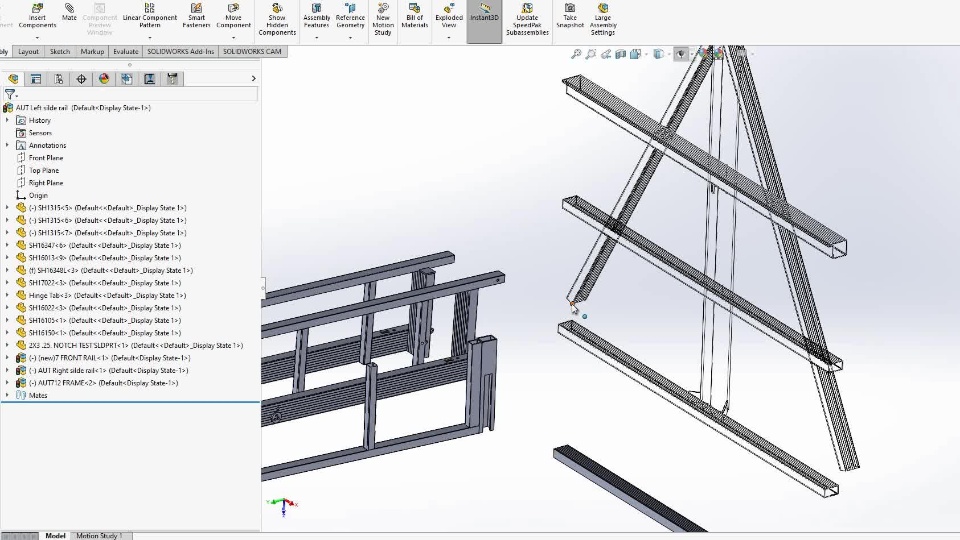

When I attempt to make an assembly with other assemblies they will come in as a wire frame shaded (which is what I want). How ever if I add a few assemblies some of the parts in that assembly come in as wire frame only and I don’t want that. If I select the part it will display normally but when I hover over it it goes back to wire frame only. I can’t find a solution please help. it started this after I updated from 2020 to 2021.

Go to System Option, Performance, At the bottom, Enchanced graphics performance
Turn it on/off

I should get paid for this

THANKS!
