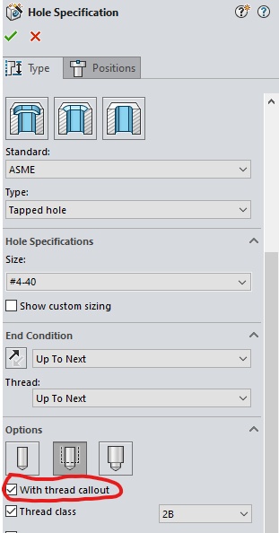

I am trying to figure out how to find all hole wizard features that have the "With thread callout" checkbox selected and deselect it in a macro. I have the code for traversing the feature tree and finding all tapped holes, but I can't seem to find a way to get access to the "With thread callout" setting. Any ideas?
I also need to remove all automatically added hole callouts in the drawings due to the "with thread callout" setting. Is there any way to identify them?

Would this example help you?http://help.solidworks.com/2019/english/api/sldworksapi/create_holes_using_hole_wizard_and_sketch_points_example_vb.htm
See my macro here to toggle 'with thread callout'
https://r1132100503382-eu1-3dswym.3dexperience.3ds.com/#community:yUw32GbYTEqKdgY7-jbZPg/post:g7mswjh_R6OK9ODJjrJPww
Hopefully solves your issue #1
Looks like this example would let you find which dimensions are hole callouts, if you could set up the macro to traverse all of the dimensions in the drawing, then use IsHoleCallout Method (IDisplayDimension)...lemme know if that is what you're wanting
