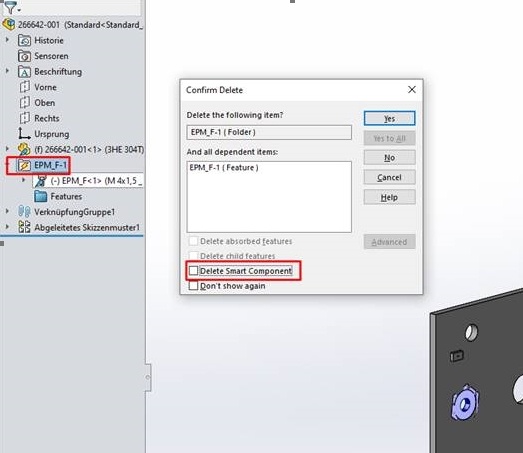

I tried to delete the folder that contains smart component without deleting the components in an assembly.
Sub DelSCFolder(SCName as string)
Set Part = swApp.ActiveDoc
boolstatus = Part.Extension.SelectByID2(SCName, "FTRFOLDER", 0, 0, 0, False, 0, Nothing, 0)
'Part.EditDelete
boolstatus = Part.Extension.DeleteSelection2(0)
End Sub
Both delete lines will delete the folder and the components. I need the components in the assembly afterwards.
With UI it is able to delete the folder only.
Any ideas how to handle that?
