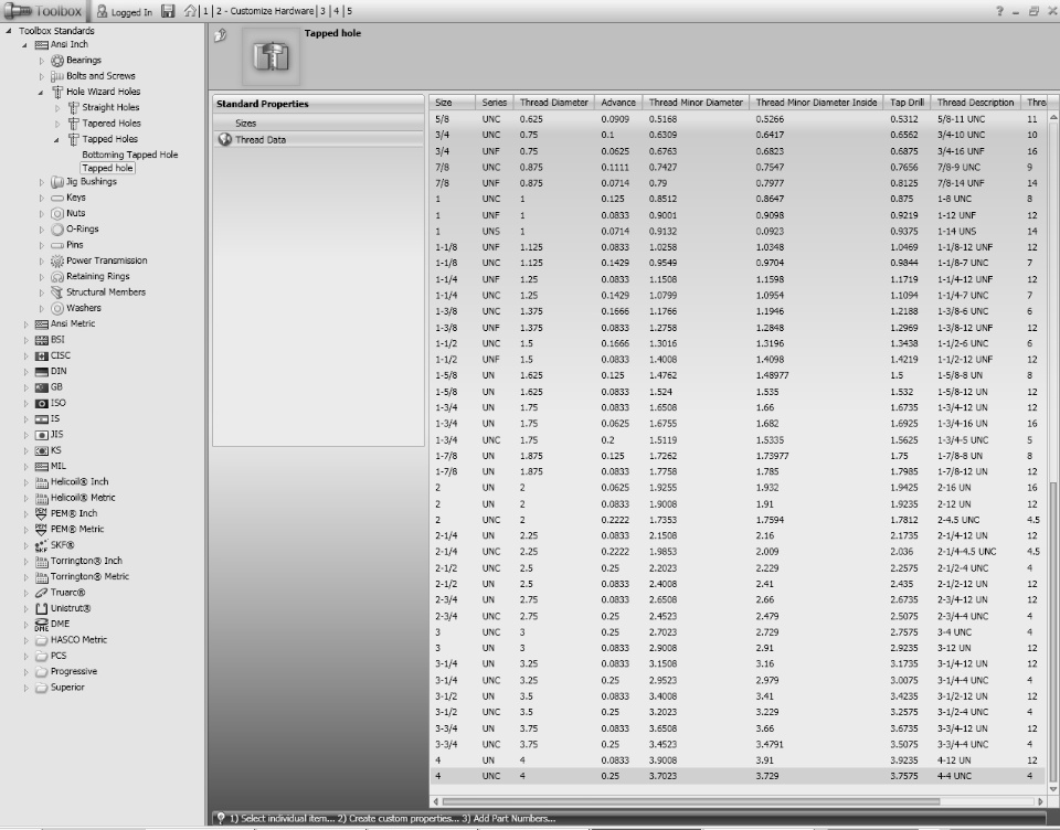

Adding Tapped Holes to Hole Wizzard
Is it possible to edit some sort of table somewhere to add anM30 x 1.5 Tapped Hole, so it can be inserted using the HoleWizzard?
If so, where would I find the file?SolidworksAdministration

Tools > Options > System Options > Hole Wizard/Toolbox > Configure.  From there you can create a new standard (required) that you can add to or removed from or modify as desired.

I did a session at SWW 2009 on the Hole Wizard which goes through a new standard creation and adding new hole definitions to the new standard.  Its called "How to use the Hole Wizard Effectively".  If you have access to the Proceedings from the event, download that from the SW site.  It gets into some deeper stuff at the end that you need to be VERY sure you have back-up copies before altering any of the data inside the database.  The Hole Wizard interface was completely revamped for SW2009, and there was some missing functionality in SW2009 sp0.0 and 1.0.  They got the functions in by sp2.0, so if you are in SW2009, you NEED to have at least sp2.0 or greater to have the "create new standard" functions.

You have to create a new standard.  You can create a copy of the entire ANSI Inch standard, then make changes to that.  These become the company standards that you will use.
Also be sure you are working in a later SP as Brian Lindahl points out.  I would recommend the latest for SW2009, SP4.1.

I have just managed to create a new standard by using the presentation Brian Lindahl directed me to thanks for that link Brian.
I do have another question now that I have managed to add a new hole size... how do you delete off unwanted ones? There is a + to add but can't find a - to delete. Do you just have to overwrite it with another size?
Also, When you input the data it appears possible to input the size without thread data and vice versa. I assume that when you input both with the same size solidworks will automatically see them as one entity but will it cause problems if you only put in size or thread data? thought it best not to mess around too much as I haven't had a crash yet today and wanted to keep it that way.

I believe to remove a line just click on the line in the table and press the delete key works.
Entering new thread data for an existing size is covered in the powerpoint I directed you to.  I have never tried to enter thread data for a size that is not pre-defined before entering the thread data - sounds like a recipe for trouble.  Adding the new fastener size before adding the thread data for the new size just sounds like the right path.
