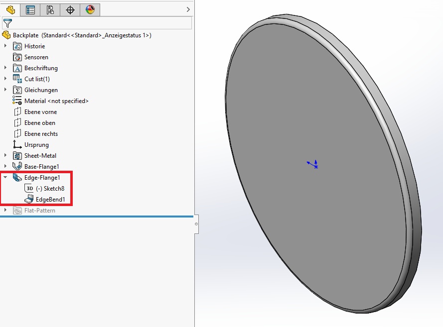

Hello,
I am trying to add an edgeflange to a circular sheet metal by using the function “IFeatureManager.InsertSheetMetalEdgeFlange2”. This function requires a sketch created with the function “IModelDoc2.InsertSketchForEdgeFlange”. The created sketch is a 2D-Sketch. But when I create the edge-flange-feature by hand it uses a 3D-Sketch.
Is it possible to create this edgeflange with api at all?
