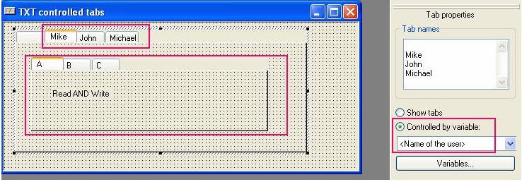

Add security control to file card

Yes, by using a tab control that is "controlled by variable" , you can have the layout (i.e. restrict fields with read-only access) change depending on logged in user.
You create a "main" tab control having the name of each of the 3 users, set it to "controlled by variable", "" (the empty tab will show for any user not matching the tab names) - then make copy of your existing a,b,c tab control and place it in each user's tab, and then apply read-only for the various edit fields.
Have a look in the administration guide, Controlled Tabs, "To change card layout depending on logged-in user:" (pg 99)
