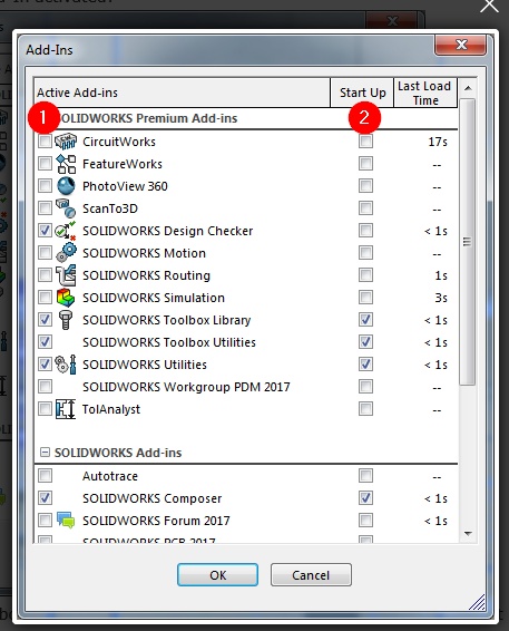

Ok, here's my question:
See the picture below:
If column 1 is for loading the add-in in the current session and column 2 is for automatically loading the add-in in future sessions,
Then why is it that, for some add-ins (like Design Checker, apparently), you have to restart Solidworks to get it to load?
Don't get me wrong, I don't mind having to restart Solidworks, but if you truly DO have to restart Solidworks to get it to load,
then what is the left column check box for (for that particular add-in) at all?  There is no point to even having a check box there.  Just have the one on the right and be done with it.
I am guessing that I don't understand something (which is why I am asking the question).

Actually, I meant it the other way around from what you are stating:
As an example, Dave checked the left box and the right box.  The left box loads the add-in immediately, while the right box loads the add-in next time you start Solidworks.
However, the add-in did not work until he restarted Solidworks.   Meaning that the left box completely failed in its function.

I see what you mean...I haven't been using it enough.  I just checked 2017 SP3 and when I tick the checkbox on the left, you are right, it doesn't appear to do anything.  However, if I untick that checkbox Design Checker disappears from the flyout on the right, and I have to go back to Tools>Design Checker to activate it again.  This is confusing functionality.

Hrmm, maybe not.
I was originally commenting on the issue that David Krum was having.
I was always wondering why there was a "Last Load Time" for the Design Checker even though I left it turned off!
So, with it turned off, you are saying that I should still have full functionality for the Design Checker.
So, I run Design Checker -> Build Checks
The look at my Tools --> Add ins and suddenly it is checked.
Interesting functionality.
I am curious then.   Why is the Design Checker even listed in the add-ins section?  Is it just to turn it off and remove it from memory once you are done with it?

Yes, it is a bit confusing since it is inconsistent from a UI standpoint, but for the add-ins that have lots of UI (like Simulation, PhotoView360, etc.), we didn't want to have that UI visible to the user without the add-in loaded because the UI would get overly cluttered with things they might not use often. For those that we don't have the full UI visible when the add-in is not loaded, we put the option to turn them on/off in the SOLIDWORKS Add-Ins tab of the CommandManager to try to make them more discoverable than how they were prior to SOLIDWORKS 2010 (which was only in the Tools, Add-ins dialog, which is not discoverable at all). So there are a couple of levels of "discoverability" of add-ins that we added with SOLIDWORKS 2010:
  1. For add-ins with a small amount of UI, just have the UI always present in the logical places; menus, CommandManager (mostly in the Evaluate tab), etc. and have the add-in load automatically when you choose the command.
  2. For other add-ins, have the UI to turn the add-in on/off in the SOLIDWORKS Add-ins tab of the CommandManager. When you turn the add-in on, one of two things happens.
    1. For most of the add-ins, UI gets added elsewhere like additional CommandManager tabs, menu items, etc.
    2. For *some* of the add-ins like SOLIDWORKS Toolbox (the utilities, not the content), the buttons for the add-in get added right at the end of the SOLIDWORKS Add-ins tab of the CommandManager, lacking a better place to put them (it's not worth adding a whole new CommandManager tab for just 5 buttons.
If you are using network licenses and an add-in requires a certain license to run that add-in (i.e. a Professional license rather than a Standard license), then yes, the license will be locked when the add-in is loaded. So, the Startup option on an add-in from a higher level license does provide the ability for a user to lock the license when they startup the software. So, actually this does remind me of another reason that we decided to keep all of the add-ins visible in the add-in dialog, even if we show their full command access UI in the software even when the add-in is not loaded; so the user has access to that license locking functionality.
