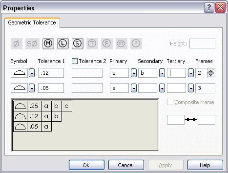

3-line composite geometric tolerance not working
We are trying to use a 3-line composite geometric tolerancefor the profile of a surface. When we do the first two lines, andselect the composite check box, it displays fine. When we add thethird line, as soon as we go to select the geo. tol. type with thedrop-down arrow box the composite check box grays out and the geo.tol. shows the following image, rather than one composite profiledistributed across all three rows.
Any ideas? This appears to be a bug.

A composite tolerance has two lines only. See ASMEY14.5M-1994 section 6.5.9.

You're absolutely correct. Sadly though, SolidWorks allows for asmany lines as you'd like (see attachment). And, of course, none ofthe information has to make any sense.

I've never seen that ASME limits the number of segments orprohibits a mix of tolerance types, so I can't see how any CADpackage could prevent the sort of mess that you show in yourattachment. I thought it was pretty good that Solidworks got thecomposite control frame right.
