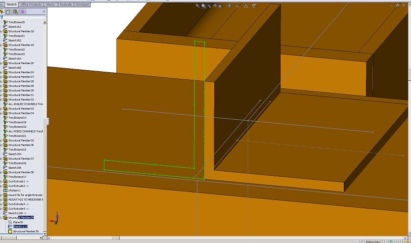

2009 sp2.0 welment profile stands alone
can not modify profile in SW2009.
Relocated profile will not go with weldment body. Sketch profile stays at the original position separated from relocated weldment.
See attachment. I rotated profile 90deg. Body have relocated. Profile stays at original location.
Any idea how to fix it?SolidworksWeldments

I have it rotated as you can see in the attached file. The problem is that after rebuilt sketch did not rotate. It jumps back and stays separated from body it's belongs to.
What I need is to have sketch profile in line with the body. We use custom profiles and modify profile sketch dimentions in the model. Till now it worked smooth.

try. Insert weldment. It's uneaqual angle in attached screen shot. I need to rotate it 90 deg. Locate profile :90 deg. Rebuilt. Angle body will be rotated. Weldment Profile Sketch will not. It stays at original location.

The engineer at Solidworks suggests that this issue relates to the method that you are using to construct the weldment, and is not a fault.
He has created a sample file (which I have attached to this email) to demonstrate the required method. You could also take a look at the tutorial covering this subject, as this may help to clarify.

basically what they are telling us is you can not move or adjust the sketch profile anymore. you have to align the driving sketch ie the constuction line to exactly the point where you want the member to be. This means in most members you have to dimension the line the extrude follows to the centre of squre tube for instance, accounting for its size ie subtractng or adding the distance to the centre of the sketch profile if its 4" squre tube or box section you have to add or subtract 2" to allow for where the placement of the sketch is as the constuction line will now only ever work from the centre of the box section or any member in fact

This issue only occurs when using the downloaded profile from the solidworks content ansi iso bsi.......
it seams to be alright if using the weldment profiles which come with solidworks install ansi iso but theres not much to chosse from

ok maybe I am missing something here but I dont see the issue aside from the sketch not showing as moved when highlighted in the FM.
Do you want to reuse the sketch or something?
I can relocate the profile pierce point as I please and rotate, mirror and change the dimensions in the sketch and the weldment builds as desired.
This is using the downloaded zip profiles...
The BOM lengths and angles are correct

Myself, I skipped from SW2005 to SW2009 so weldments are new to me. After using it for a while, I thought that the weldment profile was meant to stay in the original position because that how all of them behaved once rotated. After reading this post I realized that when using "model items", they are dimensioning the profile and the profile is off to the side and hidden. This causes lots of confusion in the shop when the guys see dims not attached to model lines.

Weldments are actually in 05. I just checked up on this again myself and I see Lana's point now and yours - in 05 the sketch moves in 09 it doesnt.

Wayne is right. I double click weldment body (angle in this example) to modify angle size. Dimensions in profile is automatically updated in Weldment cut list.

You can edit the profile sketch and use Modify to rotate the profile.
