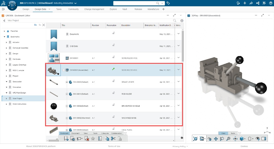

An option in the app that I’ve found to be very helpful is “Allow Products to Expand”. By enabling this option, it will allow you to expand the structure of an assembly, in order to see all of it’s children.
An additional benefit to this is that when you’ve added the assembly to 3DPlay (previewing app), it will cross highlight the selected child within the previewer

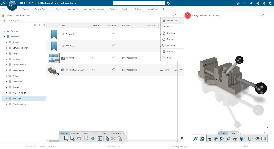

To enable this option, do the following:
- Select the down arrow at the top right corner of the app and choose “Preferences”

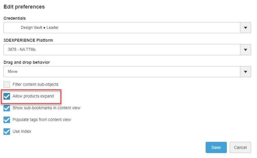

- In the preferences dialog, choose “Allow Products Expand” and then choose “Save”
