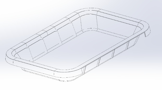

If you are experiencing the issue where the shading is missing and the model looks rendering outlines only like this:
To resolve this issue:
- Please rollback your driver to a version older than 530 or update to 535.xx or newer.
Additionally, there are a couple of possible workarounds if the driver update is an issue:
- Disable “Optimize for thin parts” in the display options
OR
- Disable “Enhance Graphics Performance” in Performance options
