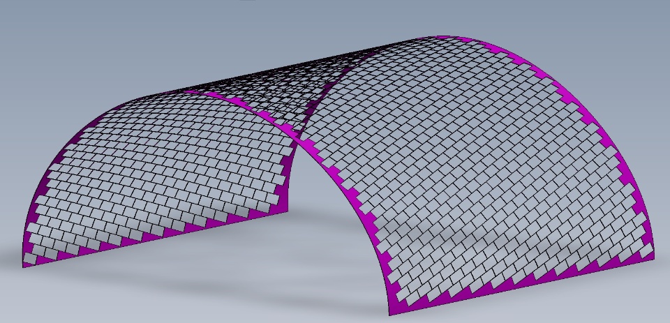

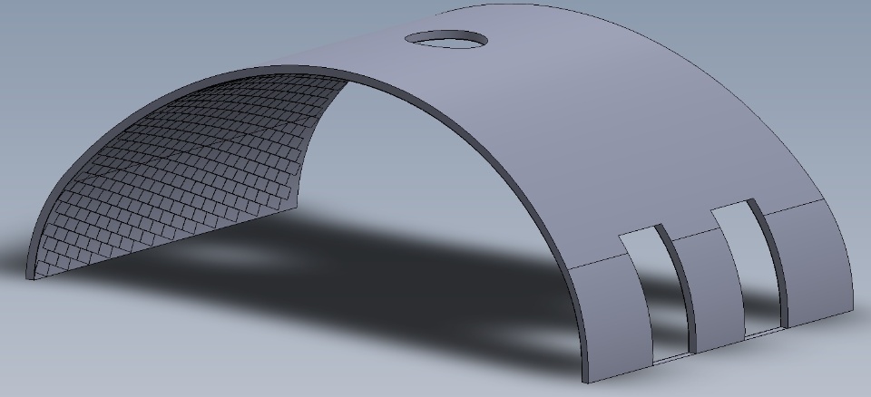

- Obviously, designing new machinery as part of my day job provides me with challenges aplenty that I can solve with SOLIDWORKS. However, the most fun that I derive from using SOLIDWORKS is when someone on the User Forum asks a question or seeks help for a modeling problem that has them absolutely stymied. For example, a fellow recently posed the problem of creating a "tiled wall" look on the interior of an elliptical tunnel section. He'd tried Wrap and Projected Curve features but they weren't giving the results he wanted. I took a different approach. I modeled the tunnel wall as a Lofted Bend and then Unfolded it. I added a pattern of cutouts that were the size, shape, and orientation of the tiles. The resulting part looked like a huge grid. In essence, it mimicked the "grout lines". I added a Fold feature back to this model to restore it back to its barrel vaulted shape, and lastly, used a Combine feature to boolean subtract the grout lines from the wall of the tunnel. Voila, the tunnel now had a tiled wall appearance that curved from floor to ceiling and back down again. It's unconventional approaches that really get my creative juices flowing - finding ways to make the software create the type of geometry or topology that, by most folks thinking, it should not be able to do!

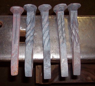

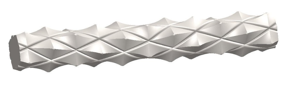

- No need for more than a moment's thought to answer this - the Flex feature! I genuinely cannot think of a practical application for it in my day to day workflows, but, by golly, I am totally in awe of what it can do to utterly manipulate, distort, and create geometry that you be hard pressed to model conventionally. Here's an example. A few years ago, I took a blacksmithing class at a local art center. We learned how to make a pineapple twist. You take a piece of square bar, chisel grooves along the length of each side, twist it in a spiral, pound the spiral edges flat, cut 4 more grooves down the lengths of these newly flattened sides, and then twist it back the opposite direction. The result looks like the skin of a pineapple. Using SOLIDWORKS and the Flex feature, I was able to duplicate the process 100% faithfully.
