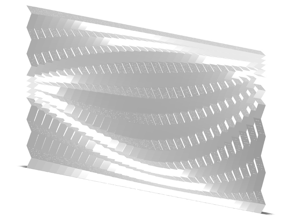

Take a sneak peek at our design below, and come back later as this post will be updated to include:
  • A video link for a replay of the webinar
  • We’ll enable the ability to download our model below
  • And if we get too many questions to answer, we’ll post a PDF with answers to all the questions we didn’t have time to answer live

Downloadable Model
The model shown above is now available for download.  Just select 'Download' from the drop-down menu at the top-right corner of the preview.

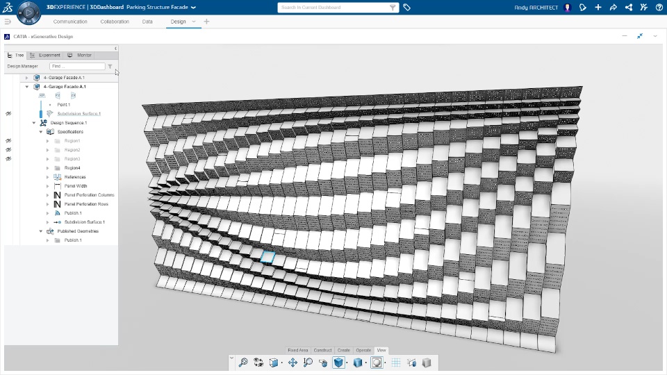

Possible use EKL in xgg?Yes, xGenerative Design, the app contained with the 3D Pattern Shape Creator role, supports writing code directly in the Enterprise Knowledge Language (EKL). There is a specific type of node called a "Script" node where you can write your own code.
Can the process to prepare the panels for manufacturing be automated for each panel? If yes, in which app?Yes! This could have been done in the xGenerative Design app, but we wanted to make sure to display the great capabilities of the xDesign app as well.
The work Dan did on the singular panel to prep for manufacturing, would that need to be repeated on each unique panel, or do those prep for manufacturing details also scale across the whole design.Great idea! As mentioned earlier, we could have accounted for those flanges within the xGenerative Design app.
What about using existing catia models and cross collaboration between desktop & web versions ?There are a number of different CATIA roles on the 3DEXPERIENCE platform. Some are web-based, such as 3D Pattern Shape Creator, and others are Native Apps, which install on your local machine. All CATIA roles have a shared data model and can work seamlessly together on the same data in one environment, the 3DEXPERIENCE platform on the cloud.
What roles are you using? Is it CATIA or SW roleIn our webinar we demonstrated both SOLIDWORKS and CATIA web applications. 3D Sculptor (xShape) and 3D Creator (xDesign) are SOLIDWORK brand apps while 3D Pattern Shape Creator (xGenerative Design) is a CATIA brand app. All were developed as 3DEXPERIENCE native web apps using the 3DEXPERIENCE Convergence Geometric Modeler (CGM).
