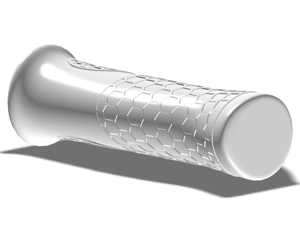

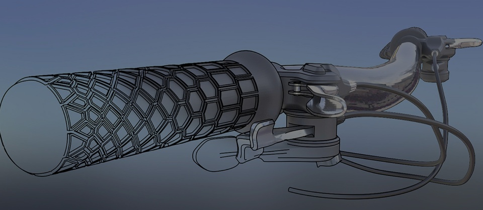

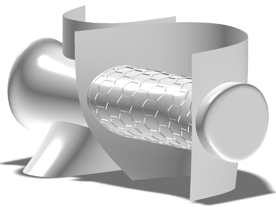

Take a sneak peek at our design below, and we'll show you how we created it Thursday!

Could you control the depth of the pattern? Perhaps going from negative to positive along the grip?Absolutely. Within the workflow we can setup ways of varying the pattern depth. For instance, for the spiral pattern the grid of points could have an offset dimension which varies. This would allow the tubes swept along the wireframe to come in and out of the grip body. Then we could have both a Remove for cutting and an Add for combining the portions that rise out of the grip. Thanks for asking. It's a cool idea.

In the xGenerative marketing flyer, it mentions jewelry as one of the industrial uses. Do you have any examples or images of jewelry being designed in xGen?We have a number of examples of jewelry designed in xGenerative Design (the app inside 3D Pattern Shape Creator) but unfortunately their are proprietary to the customer and cannot be shared publicly.
Is it spelled borno pattern?Voronoi
What is the file format for publishing these different shapes? In other words, once the design is finished, what is the intended workflow for getting a physical product in your hand (dependent of course on the size of your product)?3D Pattern Shape Creator produces Physical Products. These can exported from the 3DEXPERIENCE platform as neutral file formats that can be handed off to machinists or to 3D Printers.
How is that complex pattern going to translated to being manufactured?That, of course, will depend on what type of CAM software you are using. The higher end tools would be able to automate the toolpath creation where the lower end tools may be much more labor intensive. It would be a great idea to try this Voronoi pattern handle out on SOLIDWORKS CAM and DELMIA roles.

Is there a database of predefined patterns setup so you could maybe match existing patterns out there for stippling or other laser type textures out there from molding vendors?Within 3D Pattern Shape Creator there are a growing library of out-of-the-box features (e.g. the Voronoi node) for developing intricate patterns. The intention is for this role to be very open and flexible in how you develop your own patterns. Many current customers are composing their own workflows using the out-of-the-box features with some custom scripting (in some cases).

What happens when Andy pulls that model back into SW?In the background, 3D Interconnect is importing a .SLDXML. What you see is a SOLIDWORKS Part that you can mate into your assembly, modify, create a drawing from, run a simulation on, etc...
Is it possible to add this kind of parametric design for, say, a hole pattern on an existing SW part?Absolutely, you can bring SOLIDWORKS geometry into 3D Pattern Shape Creator and you can export geometry back into SOLIDWORKS.
