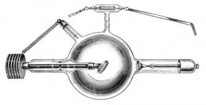

Let’s briefly consider the genesis and early development of X-ray tubes. The first purpose-designed source was the so-called Crookes tube, shown in Fig. 1(a), developed from the tubes of the same name that were used to generate and accelerate ‘cathode rays’ – later identified as electrons. In 1895 Wilhelm Röntgen first noticed that the original tubes produced emissions – X-rays – that could cause fluorescence outside the tube. These tubes used a cold cathode and contained residual gas at low pressure (<~1mTorr). A high voltage between anode and cathode generated a plasma from which the ions were accelerated to the cathode, producing secondary electrons; these electrons were accelerated towards the anode – generating more ionization en route – where they produced bremsstrahlung radiation.
These tubes were not particularly reliable and, over time, the residual pressure reduced as the gas was absorbed by the walls of the tube; it then needed to be replenished by heating a side-tube containing a material that had previously adsorbed gas. The Coolidge tube, shown in Fig. 1(b), invented by the eponymous Dr Coolidge in 1913, improves on the performance of the Crookes tube. It uses a hot cathode thermionic emitter – often a wound cathode filament – and operates at a higher vacuum. Electrons are accelerated towards the anode where the X-rays are generated.
Fig. 1(a) Crooke’s X-ray tube
Fig. 1(b) Coolidge X-ray tube
In this blog, we will concentrate on the Coolidge tube, which in principle is quite simple. Despite its age, modern tubes are still based on this same general concept of an electron emitter: accelerating/focusing electrode and high atomic number target – although we might now consider cold-cathode, field-effect emitters as well as hot thermionic emitters as sources of electrons.

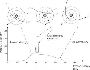

In the X-ray tube we have a beam of energetic electrons incident upon a target made from a material of high atomic number. Deflection caused by the nuclear charge of this material produces bremsstrahlung radiation and the different degrees of deflection give the radiation its wide, continuous energy (and wavelength) spectrum, with the maximum at the energy of the incident particle – as indicated in Fig. 2.
Fig. 2 Mechanisms of X-ray generation
While bremsstrahlung is responsible for most of the X-ray generation, the spectrum also includes discrete energy peaks which are produced when an electron is ejected from an inner shell by a passing particle and an outer-shell electron falls to replace it, releasing a photon at the energy of the difference between the levels. Since the difference is characteristic of an atomic species, this is termed characteristic radiation.
We note here that, in principle, the intensity of the bremsstrahlung radiation would increase linearly as the energy reduces. However, in practice, the X-rays are produced at some depth in the material and also need to pass through the wall or window of the tube. Hence some absorption occurs, with the lower energy emissions being absorbed to a greater extent than those at high energies. This is known as inherent filtering;. External filtering may also be applied to tailor the spectrum, such as in diagnostic X-rays. In this case removing the lower energy components is beneficial since this region would be absorbed by the patient’s body, thus increasing the dose without giving diagnostic (transmission) data.
