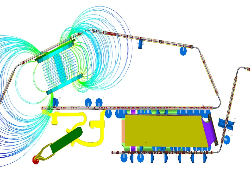

What is a T-coil and why is it important?
We are looking into three wireless systems in our hearing aids. One of those is the T-Coil, which is picking up an electromagnetic field in the audio range at very low frequencies of only a few Hertz. A T-coil is essentially a wire wound around a rod, designed to pick up magnetic fields from induction loop systems commonly found in public places such as churches, temples, railway stations, and theaters. One of the key challenges is that hearing aids also contain other wireless systems, like the near-field magnetic induction antenna and the RF antenna. These systems need to coexist, but the T-coil is highly sensitive to their magnetic fields.
To address this, we use simulation to understand the interference between the different systems. By modeling the T-coil and the entire hearing aid, we can study the coupling between these systems. Simulation enables us to analyze the interactions and develop effective solutions.
Stephan Lensing, Simulation Key Expert, WSA Erlangen

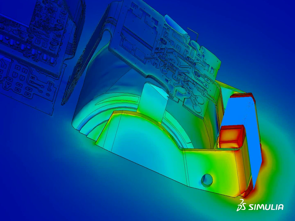

How do hearing aids communicate with one another?
The second wireless system is our near field magnetic induction (NFMI) link, which establishes communication between the left and the right hearing aid. They can exchange commands and even digitized speech to enable advanced signal processing for better hearing.
The MI link uses Near Field Magnetic Induction (NFMI) and it is based on the principle of resonant inductive coupling between two matched coils which form an LC circuit working on the same resonant frequency. We transmit the magnetic signal from one ear to the other ear, so it is basically the short-range wireless communication. The MI link consumes very low power and the field strength is really low, and there is a lot of interference with the other electronic systems in the hearing aid.
We test in a virtual environment so that we can understand the problem beforehand, and we could locate the aggressors in the simulations and we could visualise it before it comes into the picture and becomes a problem during physical testing in the lab.

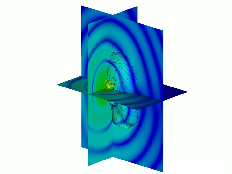

The third wireless system we have is the RF system which is used to connect the hearing aid to a device in the outside world.
We want you to be able to connect your hearing aid directly to your smartphone, to your TV or to other devices in the world outside. The main challenge is that the body is in between and waves propagate quite differently along the body than they do in free space.
We set up a simulation where we placed the hearing aids on the ear and included the full body. We were able to create a very fine mesh, create the field source and then bring that to a body phantom in CST Studio Suite, allowing us to understand how the waves propagate along the body. If we didn't have CST Studio Suite, we wouldn't have been able to optimize the hearing aid in that way.
