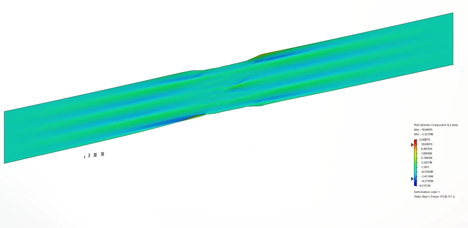

Wrinkles from Stretching
This is an Abaqus/Standard simulation of a thin elastic-plastic strip that is gripped at the ends and stretched. The plastic straining in the middle generates wrinkles which I find interesting. The procedure is quasi-static implicit dynamics. There is an imperfection from a previous mode extraction. The video was made in the Physics Results Explorer app. The result being contoured is the out-of-plane displacement.
