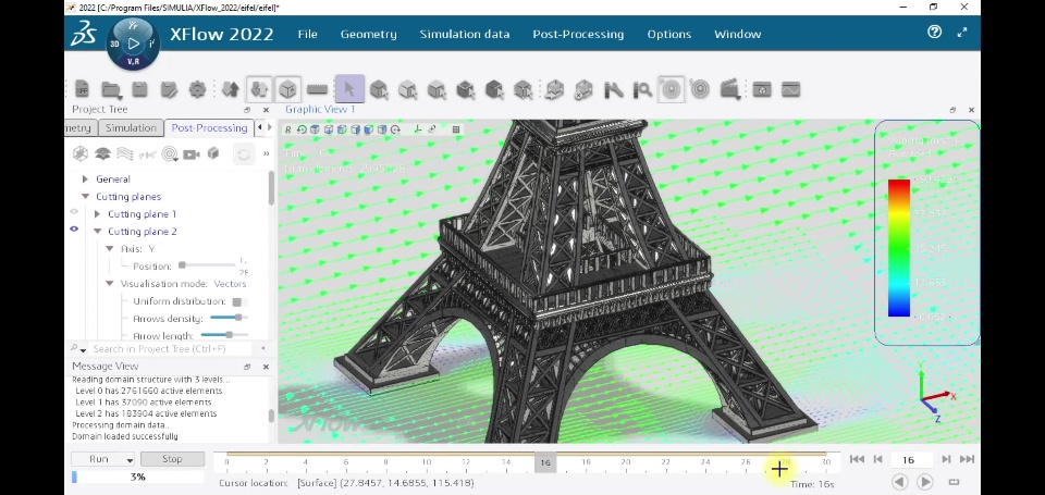

  • The simulation incorporates a full model of the Eiffel Tower and follows predefined boundary conditions. The flow is introduced from the negative X direction and exits the wind tunnel from the positive X direction. The simulation assumes a reference density of 298 Kelvin for the air.
  • Modification I made was to use the non-equilibrium enhance wall model, which is well-suited for external aerodynamics simulations. This model accurately captures the separation of the flow field by properly accounting for pressure gradients.
  • In the visualization, we observe vectors representing the velocity colored by magnitude in the ground . This allows us to observe how the velocity interacts with the tower, resulting in a few recirculation areas.
  • It's important to note that since the wind is coming from the X direction, the effect on the tower is not significant. If the wind were to approach from a different direction.

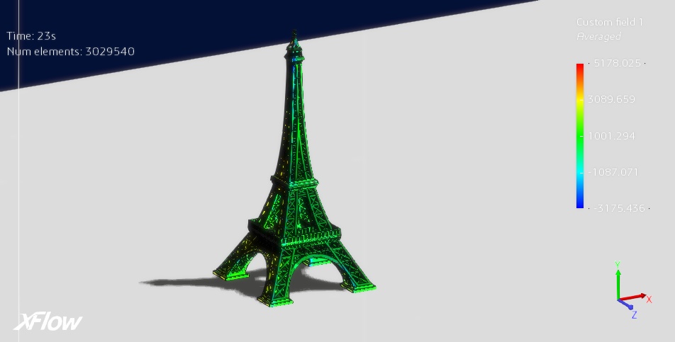

  • And in surface pressure visualization, which shows areas of high pressure where ,the velocity hits the tower and areas of low pressure at the back.
