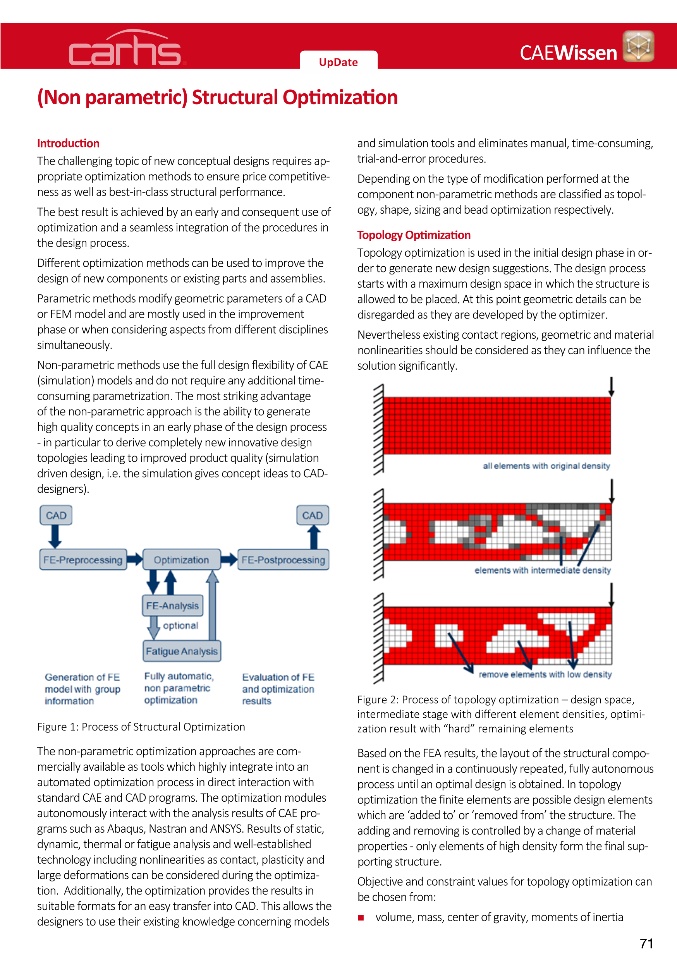

Structural optimization tools like Simulia Tosca Structure provide methods to create designs with optimum relation between weight, stiffness and dynamic behavior. These include
  • topology optimization to derive optimal design suggestions from a given design space
  • sizing optimization to find optimum sheet thicknesses
  • shape optimization for efficient product improvements through specific design modifications
  • bead optimization to find the optimum layout of bead stiffeners for sheet metal structures
If you just quickly want to know what's behind these terms - my introductory overview on these optimization methods is given in the following article (in english language) recently published as CAEWissen (CAE knowledge) in the German automotive CAE companion. A print version or the full pdf version of the companion can be ordered at https://www.carhs.de/en/companion-poster/product/caecompanion-print.html.
