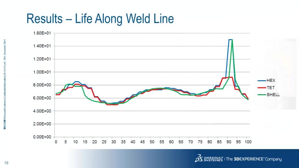

At our User Group Meeting, SIMULIA Colleague Pawel Sobczak spoke about a study of modelling methods for meshing welds to be analysed using the structural stress methods in fe-safe, for later analysis with the Verity module in fe-safe.
I find myself referring users to this information regularly when they ask "do I have to mesh the welds"? Watch this short recording to find out!
