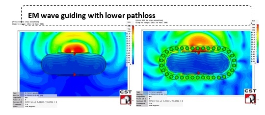

The product he works on are meta-materials – materials that bring together a composite of elements to achieve electromagnetic properties not found in nature. In this case, numerous small resonators made of a material with a high dielectric permittivity are embedded in a substrate material to form a “high dielectric resonator” (HDR) array. Kim’s goal is to find a resonator design that maximizes the power transfer.
Electromagnetic simulation in SIMULIA CST Studio Suite is a powerful tool for designing these resonators. A quick calculation of the properties of a single resonator with unit cell boundary conditions can be used to predict the behavior of a huge array of resonators very efficiently, allowing Kim to find a resonator geometry, spacing and material properties that offer the best transmission behavior in the required frequency band.
Once the initial resonator type is chosen, it is then integrated into the fabric. The 3D structure can be modeled in detail and bent around the body to simulate how it will work when worn.
Using simulation, Kim’s team was able to design an HDR waveguide that significantly improved transmission between wearable sensors. Measurements on a physical prototype agreed with the simulation and showed an improvement of 20 dB for the coupling between two antennas when using the HDR waveguide, as compared to free space. As a result of the work, the development process was significantly accelerated and 3M was able to use the modeling results to support their patent filings on this innovative new technology.
