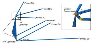

An Abaqus finite element model was developed for the right front suspension corner, shown in Figure 1, to determine member loads and suspension compliance.  The finite element model was initially developed with beam elements, allowing axial, bending and torsional loads, and connector elements to represent kinematic degrees-of-freedom of the joints.  Welded control-arm members on the upright, simplified pull-rod (PR) mounting brackets on the upper control arm (UCA) and the toe-rod (TR) were also represented.  The pull-rod member actuates the spring and damper through the bell crank to the wheel assembly, previously mounted on the upright, Figure 2.  The front-corner model used several design load cases, revealing reduced axial loads and increased bending moments reducing the critical buckling load of the compressive members.
Figure 1.  Corner suspension assembly with components labeled, beam/connector FE model.
Figure 2.  Detailed representation of the upper control arm and pull-rod connection to upright.

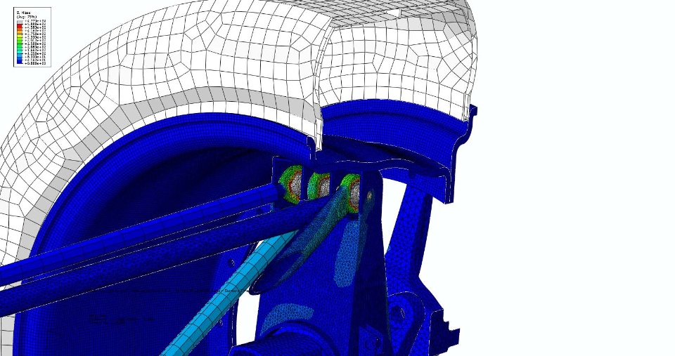

Determining which suspension components contribute most to camber and toe compliance in the suspension system requires a more refined finite element model.  The purpose of the suspension compliance model was to match camber and toe stiffness goals and breakdown stiffness on a component level.  A three-dimensional finite element model of the suspension linkage parts was developed from a full-car solid model, importing the front suspension corner parts into Abaqus.  A discrete rigid tire model was used to avoid confounding the suspension compliance with the tire elastic response.  Assembly constraints were used to locate the suspension parts, defining sets and contact surfaces in the part models.  The model makes extensive use of partitioning and sets to parameterize part meshing using C3D10M elements.  Contact-pair modeling between joint components was as realistic as practical, using shear and frictional forces between contact pairs to mimic bearing and clamp loads.  Driving condition load cases were applied at the tire contact patch with boundary conditions applied at the inboard suspension points on the chassis.  Two load cases were studied for suspension compliance, the 5g bump and pure lateral load under acceleration cases.  Figure 3 shows the displacement magnitude for the lateral load under acceleration load case and the stresses in the rod-end connections.  The compliance at the wheel center was used to estimate the overall corner compliance.  The displacements at the joints were queried to determine the load distribution and relative displacement in the rod-ends, including whether or not the joints reached the hard stops in the spherical bearing.
Figure 3. Right front corner compliance model, (a) displacement magnitude for the lateral load under acceleration load case, (b) von Mises stress in the rod-end connections.
